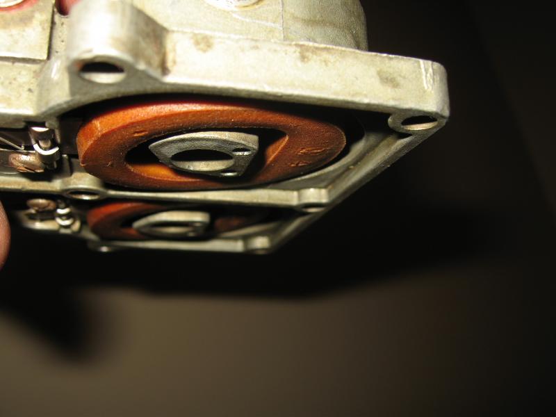

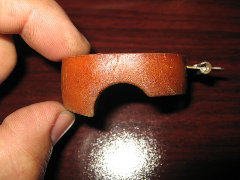

Greetings,
Model# WH 2
The service manual indicated that, when held upside down, the floats should pass beyond the carburetor body by 1/16 inch.
Well, i disassembled my first of three carbs and found that the floats move, but they don't get anywhere near passing the body at all.
Do you think the previous owner could have made this change intentionally, would there be any benefit ?
Wouldn't this prevent the bowls from filling up completely?
How would this affect the engine, I mean what would I expect to see as a result of this small range of motion?
The floats are 34 years old, what did they make them out of? Do you think they will crumble if I try to bend the metal tab ?

Something sure looks wrong.-------What are the issues with running of the motor ?-----------Could these floats be mounted upside down ??--------Why not see if you can flip one of the floats over.

The floats are definitely one sided, the other side is not flat. It does match a picture in the service manual. I just can't figure out why there is a lack of movement. I suppose I can just bend the metal tab until the desired angle is reached.
