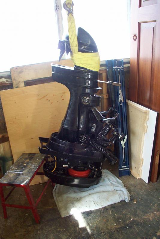

But drilling a hole in the skeg is something I never thought of, right now I have a heavy duty strap that you use for towing cars wrapped around the lower unit (i will post picture) I can use that to pull on the lower unit......

see attached pics

Ok I have had the engine hung upside down for days now, and have been spraying penatrating oil down the shaft and also heating the shaft thru a hole I drilled thru the leg. Also anchored the engine to the floor and have alot of pressure applied via a come-along....the lower unit has not moved a bit.
