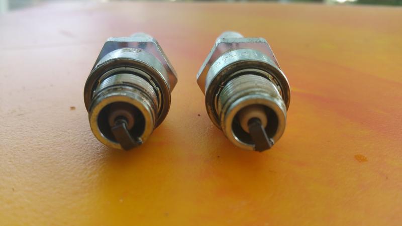

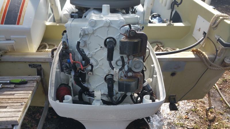

Below are pics of the motor and the spark plugs. The left plug is from the bottom piston. As you can see it is darker than the top plug. I will also attach a link to a video of it running on a hose. So now i ask, how can i fix the problem of it dying every time i try to get going? Thanks!

What manual talks about 135 PSI on this motor ?----One sparkplug shows that the cylinder is running " cool " and testing needs to be done. Do some research on " spark testing "
Will do. I didnt know what "running cool" was a thing per piston. Atleast i've never heard that before, so thank you. I will do some research and see where i get. As far as the compression, one of our mechanics here in town had a book that listed manufacturer compressions. It had 135 listed for this motor. I found that same thing online a few months ago. If i find it, i'll post it for you. But, it's just a book. Idk if that's correct or not... I used to have a '71 50hp Johnson that had a perfect 150 pounds in both pistons. So, idk. Maybe i'll just sink it and make a reef.
