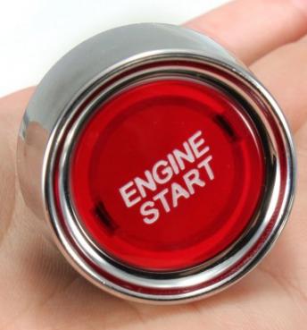

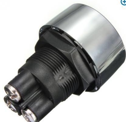

I checked it prior to taking it to him; And now I need to install a complete new modern ignition starter switch system and hope someone here can work me up a simple wiring diagram from the dash to the battery and starter using the new components pictured below; (I have tons of long wires of various colors and every necessary tool)! Please look at the new switches pictured below and the old switch is located on the shift control box and has been disabled!

Here are the new switches pictured below below!

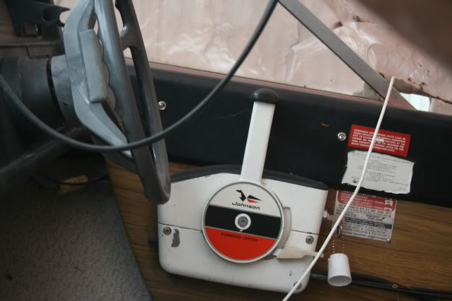

If you are talking about replacing the factory switch, I am opposed because getting the control box apart where the original is at presents a problem of getting it apart to get to the switch. I would rather get this safety systen together so if I should be thrown away from the pilots seat it will withdraw the cut-off key attached to my wrist!

OK The big round switch is "the start button" but will not work unless the safety key is inserted to complete the battery connection!
I tried but the control box "is not something I can disassemble without detailed instructions; it seems the screws are hard to find at a glance. The current key worked when turned until that guy had his hands on it (he told me he bypassed it at the motor, when testing the coil pack) now the key turns but no contact to the starter!
Again OK, if I do put in that (6 screw terminal) you mentioned I would rather have it as a dash mount (not the control box next to the pilot seat) too awkward and unsafe in an emergency. And, I realize that a battery ground disconnect can be put anywhere as long as it's wired between the battery and the ignition system ground or switch ground!

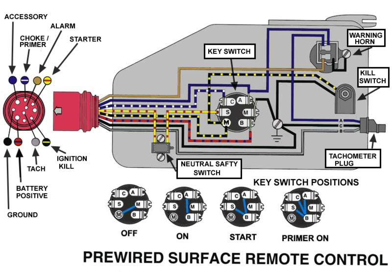

now if you want too away with all the electrical in the box its not a problem and that can be shown you dead easy.
give me ins and ill get a diagram of the key switch and box.
ok your control is possibly this one for that year, or might be newer shape. you should have the big red plug at engine end.
below Is a few pics that might help you see what you need. to do.
