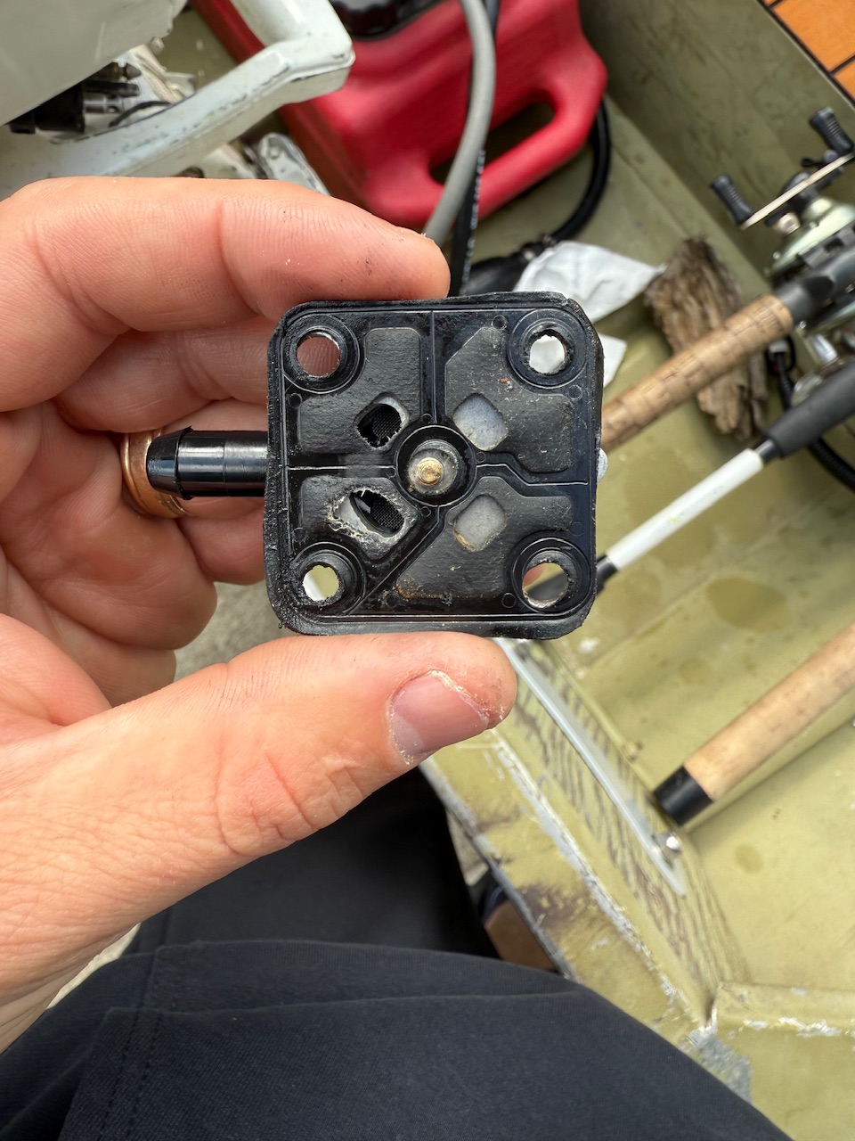

I pulled the fuel pump. Could this be an issue? Looks like it is torn out a bit?
The diaphragm is available all day long.--Note---- the diaphragm for these pumps may not be listed for a 78 model.----That pump was first used in 1968 on 3 HP models.----Used on up to 25 HP models.----.----Used for over 30 years and diaphragm is listed on some of the newer motors!!-----Repair kit is available as well.-----I would never spring for a new pump !---Pieces of that gasket may be stuck in the pump check valves.-----That gasket may not be the issue, but it can be made.----Note----Just picked up 2 more 6 HP motors ( 67 and a 69 model ) at antique motor meet.----Both had new ignitions on them.----But the skills at many dealers / shops are lacking.----And the high cost of labor has made these wonderfully simple motors a near " throw it away " item.

Unbelievable! People come here for help, not to hear the pedigree of a fuel pump without a clear path. I know these pumps very well. The kit number is 18-7823
Thank you both for the information, and sorry to stir things up. Lol
I really appreciate the part number Fitz. It has been ordered.
