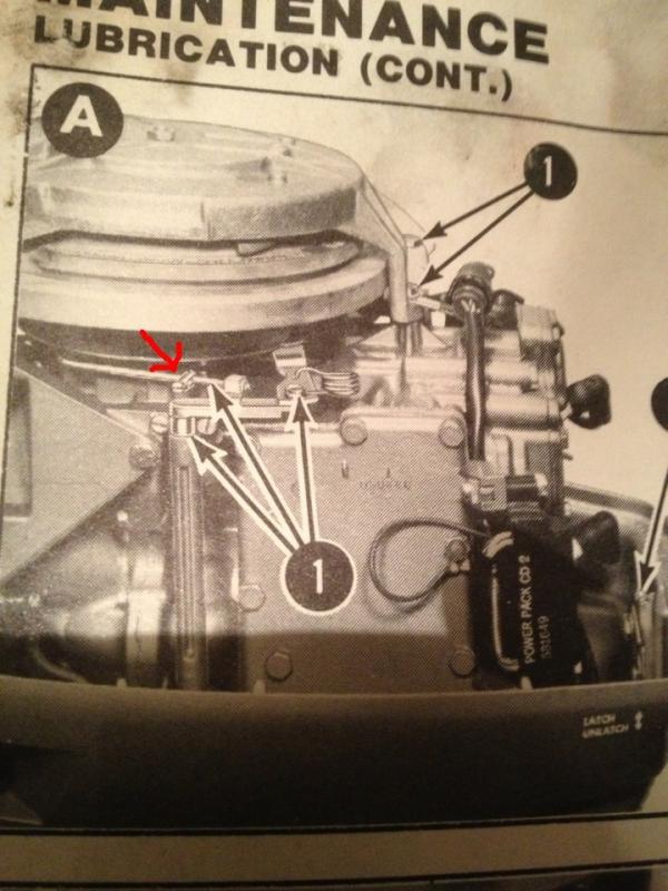

image.jpgWhere the red arrow points is the stop that broke not sure why it is back so far from the throttle piece that comes from the handle any idea what it does or why it's there?
View attachment 6542Where the red arrow points is the stop that broke not sure why it is back so far from the throttle piece that comes from the handle any idea what it does or why it's there?
I believe that's ur pivot block on ur throttle control rod...your gonna need that replaced before your throttle will work from the tiller handle...gotta have it!
Yea that's the stop I broke I'll have to fix that I see what you mean by it being at wot. I will have to replace the water pump indicator nipple where it sprays water out cause it was plugged up and it cracked when I tried to unplug it. But if these are my only problems I'm ok with that little tinkering is worth it
