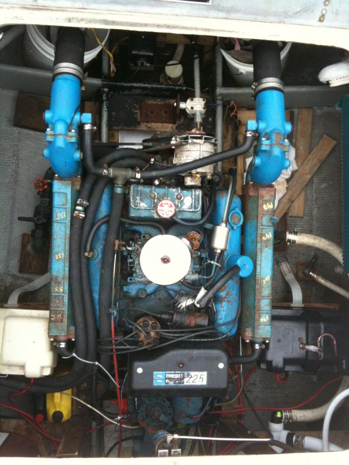

Here's a photo of my single LM318 FWC
hose going into the manifold on the right opened up
I replaced it and it has been overheating ever since.

As of today I learned that whenever you can see rust on the exterior of the surface that bad the inside is seriously worse I say the log to riser is clogged and that elbow is done
I just took the elbow of the log and it was half what you got there on the right looking at the pic
Acctually your elbow looks decent but the log is older and all that rust is going into the riser and other elbow make sure you clean those out if you reuse them
you could take the manifolds and risers to a radiator shop and have them boiled out, but be careful, if the things are over 6 or 7 yrs old, the manifolds could be in danger of rotting out. If they do, seawater will be sucked into the cylinders at shutdown, causing big problems. Also, do you get steam out of the exhaust? if so, then you got clogged manifolds or risers, Went thru the same thing 2 yrs ago, replaced both sides and problem gone.
