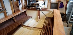

OK, everything is in place.

Made the seats out of HDepot ply....want to use it this summer and make new seats from marine ply later on. They are removable.

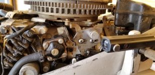

OK, first two pictures showing where everything is with current throttle adjustment or the lack of it. I think when this was the position when I had it idle a little.
Thirt picture is showing this part of the carburetor that has a mounting screw that is not what it supposed to be, and that can cause problems - don't think that will prevent the motor from starting, nevertheless I need to get a correct one.
So let's start here and hopefully you will see what is out of whack here.

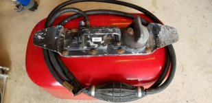

Yep, that's the old style "pressure" tank from the 1950's but it's obviously been converted to a single line tank setup with the fuel primer bulb whereas it can be attached and used on the later model engines.
Looks like everything is dry and rusty/oxidized. My thinking is that the stator plate is too far retarded to idle properly at that position. With the overall condition of your motor, I will bet that the idle stop screw unit is missing or broken off at the port side lower cowling. This HAS to be operational in order to effectively control idle stop. You can't trust cable adjustments to position the stator to correct idle position. Can you get us a photo of the area on the motor aforementioned? With closer inspection the tank could also be in a condition that would allow water to enter as well as inadequate venting. Nothing that I would allow to leave my shop, no clamps, etc....problems waiting to happen. I wouldn't be caught with THAT outfit out in the wilderness......the motor needs some service clean, up and lubrication. For instance that cam follower unit on the carb appears to be completely dry. The bendix/starter drive gear is dry, screws missing from air silencer, the adjustment for neutral start speed is completely in the wrong direction it should be pushed all the way forward not the way backwards. This thing is a mess. A little adjustment, cleaning, oil, and grease can go a long way.
Good news: I DID get it to start it. Motor runs great while pressing on cam follower......will not idle without it.
Thank you for your note Tim and Joe. I will lubricate the parts that you have mentioned. What to do about the position of the cam follower still don't know.

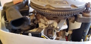

Here are few pictures I took tonight. Hopefully that will help me to understand what I need to do here for the motor to start, ide and run smoothly.

As I suspected the entire idle adjustment stop screw mechanism is missing. This is a necessary part in order for you start the motor especially with the remote control.
On the starboard side of the motor notice the 2 stainless steel phillips head screws which have to be loosened and that stop mechanism slid forward all the way to the end of the slots in the opposite direction where they are now. That will allow more throttle advancement in order to start the engine while in neutral.
