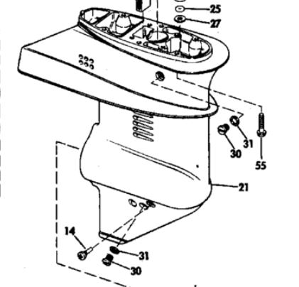

Also, a good practice when you get a new motor is to drain and replace the gear oil. You don't know how long the old stuff has been then so it's best to start fresh so you have a known point of age. I use BRP HPF PRo oil because I keep a gallon in the shop for use in my 150HP. But, BRP HiVis or just about any small outboard gear oil will work fine in the 9.9. The main thing is to have good, clean oil in the case.
When you drain the gearcase, be sure to remove ONLY part #30. This is the drain plug with a slot requiring a large flat blade screwdriver. You'll seen an identical one just about the anti-ventilation plate. DO NOT REMOVE #14. This is a phillips screw head that is the shift pivot pin and creates HUGE headaches if you take it out.
Have you ever owned an outboard before and know how to drain and fill a gearcase? If not, let us know and we'll give you the method. IF you have, then it's off to the races.

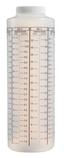

Rumtum, I'd also suggest you get an oil mixing bottle like the picture below. They are marked for everything from 24:1 to 100:1. The bottle is cheap and gives you confidence your getting the correct mix for whatever gas volume you're filling.
