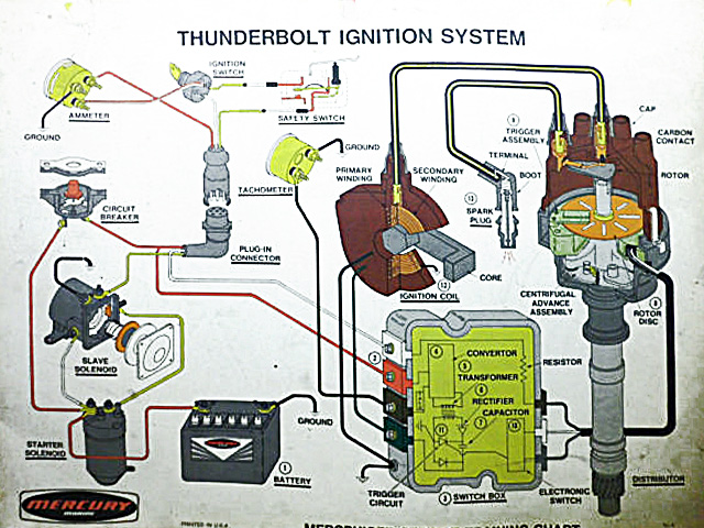

Hi,
I just purchased a 1977 150hp. It starts up and seems to run great. I pulled the cowling off and discovered that the switch box, with 4 wires on one side, and 3 on the other, looks like it has melted. There is a rubber material stringing off it and onto other engine parts. What could have caused this, and do I need to replace it? From what I have found online. They are expensive.
Thanks,
Kirk
