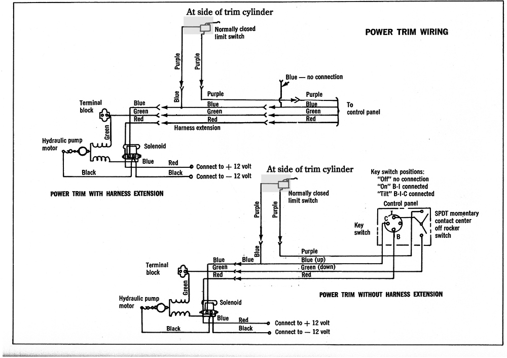

I am working on a 1976 115 horse Mercury outboard trim limit switch and need advice. The trim limit switch is very hard to get at. I am having problems trying to get the hydraulic to work so I am looking for ways to check the trim limit switch but can not get at. Any advice?
Here's a wiring diagram power-trim-wiringsmall.jpg as you can see the limit switch is normally closed so if you have a VOM it should read 0 ohms when not activated, if you bypass it with a jumper wire the unit will work but the feature will be bypassed.

My VOM shows 1 on the trim limit leads. I am assuming that I need to remove the trim limit switch. The control switch at the helm when pressed for down makes the pump slightly make a "whirring" sound. I will try the green + and the black - leads to see if I can get the motor to turn. It's been sitting for 8 years.

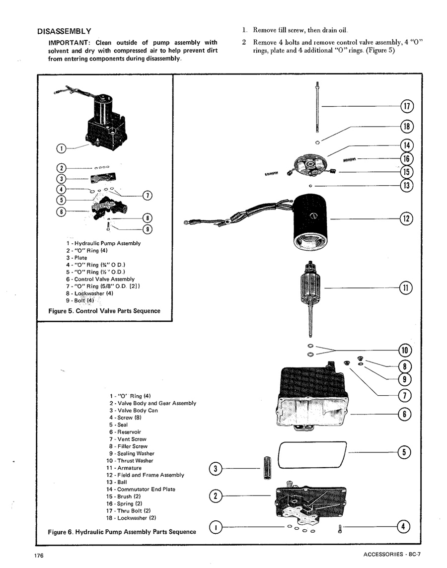

Jump the limit switch while you are trouble shooting then worry about it later; 1 ohm is close to 0 which you should be getting when in the down position. If you are going to take the motor off be careful that you don't snap the bolts and don't take the control valve assembly apart. powertrimpump.jpg
