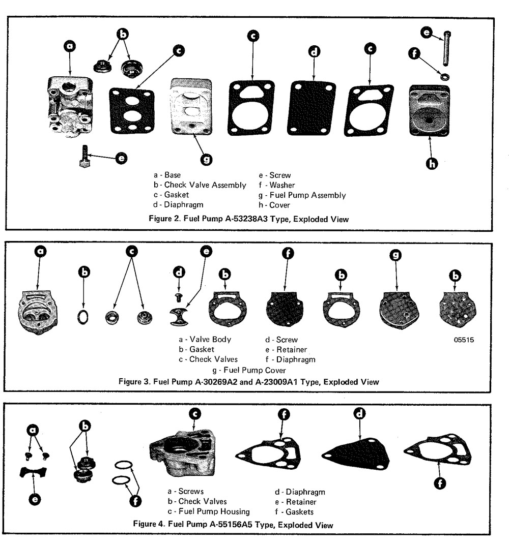

4357640 thru 4576236 were 1976 models - follow the fuel line from the disconnect and it should go into a pump on the side of the block fuel-pumps75.jpgif not it will lead into the side of the carb(s). That Amazon kit is for a carb mounted FP
4357640 thru 4576236 were 1976 models - follow the fuel line from the disconnect and it should go into a pump on the side of the block View attachment 26258if not it will lead into the side of the carb(s). That Amazon kit is for a carb mounted FP
ok yes it leads to the side of the carbs so hopefully a rebuild will get the fp working again
