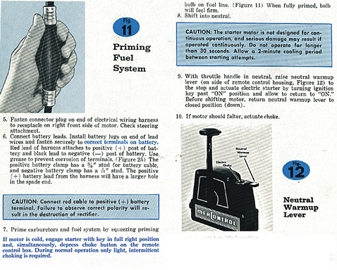

We just recently purchased an older boat and are new to engine repair, so thank you in advance for any help. When we got the boat on the water the first time, it ran, but at full throttle it was very slow. The second time on the water, the reverse stopped working, so we decided to change out the cables. We read the manual and did everything it said to get the throttle set to the idle screw and shifter set; however, we noticed that when the shifter is moved to the most froward position, the throttle lever on the Mercontrol is only about halfway up, and there is a big gap between the lever on the engine and the throttle stop screw (see attached pictures). When bringing the throttle lever on the control up more, it doesn't do anything to the lever on the engine. Should there be a gap this big?
Also, can we know we can run the engine out of water with muffs, but can we put it into gear also to make sure the prop is turning properly?
Thank you for your help!
