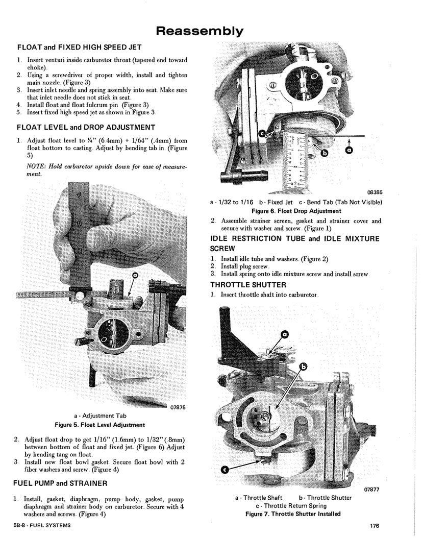

You have to adjust the float drop if this is your carb 1975-carb.jpgWhich "needle seat" do you want to replace?

Float looks good, doesnt sink in container of water. I will pull carb and check float settings. Thanks for the info.
Try lowering the float level another 1/16 of an inch.
I clamp the carb in my vise and pressure it up with a test tank to see if it leaks. If it still does, I lower the float level another 1/16 " until it stops.

I pulled bowl off the carb and the float is binding.It is rubbing against side of the chamber when it drops just a little and hinge pin is new
They show a completely non adjustable all plastic one and a float with a adjusting tab like the one I have.
Has anyone used the non adjustable one or should i stay with the standard tabbed one for a replacement?
