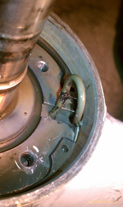

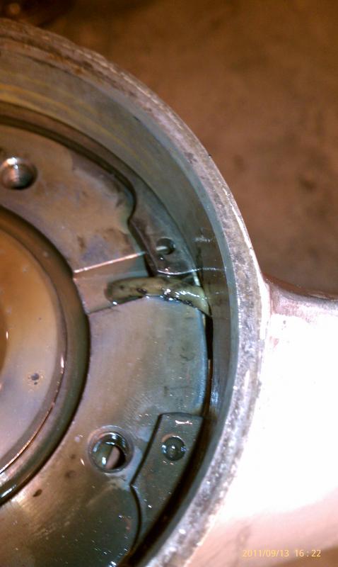

I pulled the prop and got to the reverse wire. the little plate that the 4 bolts go into that is behind the prop appears to have spun a hair cutting into the wire (as shown in the pic) pinched_wire.jpgexposed_wire.jpg
then in the second pic you can see where i pulled the wire out just a bit and tested the ohms on the reverse coil, its 6.2 and still good but now i have 2 questions:
1. can that wire be spilced with anything? like maybe waterproof heat shrink splicer? i have my doubts on that one....
2. why did it slip and cut the wire in the first place?
thanks to all in advance
I used a sleeve crimp type connector and heat shrink to put it back together. Took it out for a test yesterday and worked great. I did have quite a bit of water come in through the engine hole where the shift wires go through. I used some silicone to seal the hole since i had to replace the fried wires and it didnt hold.
