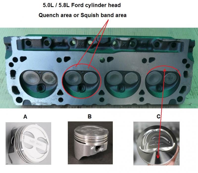

The 5.8L Windsor incorporates a wedge style combustion chamber..... very similar to the SBC cylinder head.
(see image below)
This combustion chamber lends itself to a quench surface or squish area. You can take advantage of this by being proactive with regard to quench dimension.
This isn't necessarily a HP modification, as much as it is for Marine Engine Load Detonation control.
Ignition lead can become greater, allowing our LPCP to occur a few degrees earlier....... more in line as to where it should be.
With a good quench dimension, typically the static C/R can also be increased some and without concern for detonation.
Piston deck height + compressed head gasket thickness = your quench dimension.
For this bore and stroke, you're probably looking at/near .038" to .042" quench for Marine use.
(see this thread starting at post #7 re; the SBC....... much will cross over to your 5.8L Ford engine)
Piston A is the silly "full dished" piston that GM uses in their Marine builds.
This piston lowers C/R for use with the 64cc chamber heads, but can't possibly create a "quench"!
Piston B is one profile that Ford uses as a dished piston in some 5.8L's.
This piston is lacking a quench surface.
Piston C is what a correctly built SBC Marine would use. (the piston industry may offer something very similar for the 5.8L Ford)
This piston offers a well designed quench surface, and the dish volume controls our desired static C/R.
(the piston shown is for the SBC Vortec cylinder heads)
Lastly.... find a good machine shop who won't give you that "Deer-in-the-head-lights-look", when you mention "Quench Effect" to them.
If they do, find another machine shop!
This is nothing new......... people have been doing this style build for years and years. The Small Block Chevy boys.... the Chrysler Wedge Head boys, and several more.
Street use or Marine..... and of particular importance for a good Marine build.
