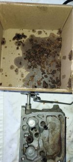

I have a guy that has done this before he has the fine needle size tools to clean all the ports in the carb. He rebuilt them both from kits I ordered off of an Evinrude site. Here is a couple pics of the crap pulled from carbs. lol bad! This motor had sat a couple years
