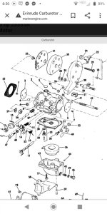

Welcome back. The main metering jet is located behind that screw plug....sometimes they are not opened to the correct size, or opened at all. This is removable with just the right size screwdriver. If you have a decent screwdriver you can grind it to fit perfectly, rounding the edges and shortening the end to make a little bit bigger size to fit the larger slot in the jet which is of course threaded in. Careful not to be hasty and mess it up in there. Once you remove the jet, you can carefully clean it to it's normal opening size. I think the 25 horse (22 cu in.) takes a 72D. Make sure that the little donut gasket is making a good seal there in the base of the float bowl.
Thanks Timguy for your response. I ordered a new metering jet. When I tried to take the old one out, the PO had messed it up. I measured the ID of the new jet and made sure the old jet was open to that size. The donut gasket at the base of the bowl is also new. Marineengine sent two gaskets with my order. Would it hurt to put both in? Something is causing the air/gas mixture not to get sucked into the combustion chamber. In your opinion, is the compression too low for that? When I had the head off, the cylinder walls were in very good condition. When it runs, it sounds very solid. Still puzzled. Thanks again!
The compression is adequate. A real healthy....as brand new 22 cu in will show 120 to 130. I sell them right down to 90 psi. Buyers love em. This is perhaps the most powerful production outboard as power/weight ratio goes. A short shaft non electric start weighs barely 70 pounds, yet produces a strong 25 horsepower. The problem you have is likely not compression related. When you shot carb cleaner into the low speed needle chamber, with the needle removed - of course, did it come out nicely from the little holes on top inside the carb throat? Screenshot_20211027-085030.jpg
If that little donut gasket part number 40 is not making a good seal then it will not be able to suck the fuel.
The term---" strong spark " ----Means nothing to me and others.------The magneto in good condition can jump a gap of up to 5/16" on a test device.----Do that test.----The crud on the reed valves may indicate moisture was inside this engine.-----Possibly stuck rings.------A few hrs of running may free them up.
Hi, Racer. Glad your here to help. Bruce.....make sure that this port I've marked for you, is open and flowing uninterrupted to the float needle valve.

Okay....l remember that. There is no need to run two gaskets in there.If there is too much clearance for the standard donut gasket to work, then something is wrong with the float bowl....it is warped from being overtightened. You can check if it's sealing by applying a little of your wife's least favorite lipstick. Then tighten normally....not too tight, then remove and look to see the action of the lipstick.
