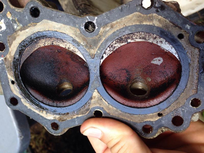

I opened up the cylinder case and this is what it looks like. Looks pretty clean to me... Though you can see that the top cylinder has a lot more moisture/fuel-oil in the chamber than the lower one
IMG_2736.jpgIMG_2737.jpg here...the files didnt upload the first time
