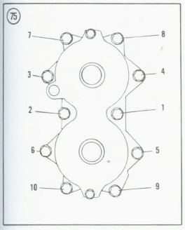

I'M taking my head off to inspect piston.Anyone have a diagram for torque and retighting head bolts?.My torque wrench only shows in.lbs. up to 800 is there a conversion from in lbs. to foot lbs. From what i have read head bolts only need 18 to 20 foot lbs.Idon't know for sure but isn't 800 in lbs within 18-20 foot lb range?
I have posted a diagram below for the torque sequence for OMC V4 heads. Your particular head may have a very slightly different bolt pattern, but basically you just work outward from the middle in a spiral pattern.
