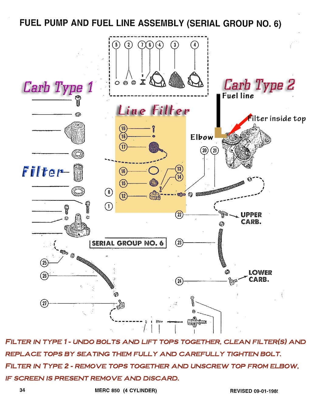

On the tops of the carbs there should be filter screens to trap sediment if they're plugged they hurt flow.
remove them and check/clean.
Awesome glad to hear it, thank you so much. I'll do this right away and I'm definitely adding a filter to the line before the pump...
