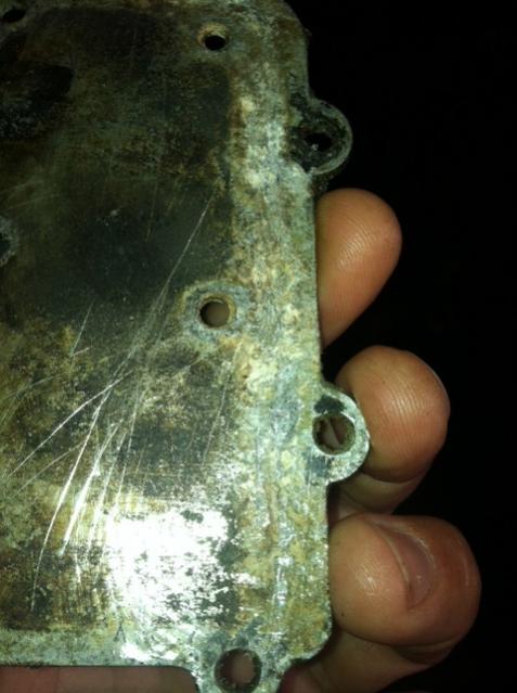

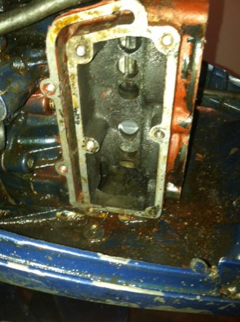

Ok. Pulled the exhaust plate. (1) bolt snapped in block with 2 threads to grab onto ! The bolt is an 'inside one' - there are a total of two inside ones.
All looks great in there in exhaust area. Gasket is SHOT! Aluminum exhaust plate looks a little pitted where the water flows.
Questions:
- The bolt that snapped - is a bolt that looks like I could get away without - but, I'd like to try to remove it - any ideas ? Its soaking in PB Blaster now.
- The exhaust gasket - it looks pretty custom - can I buy a new one, or, if I make one, what material would I use - a high temp gasket maker ?
- The exhaust plate - pitted where gasket fits - hoping that the pressure of the plate tightened down will compensate
Is there anything else I should do while this is all apart ? Once I put all back together again, I'll be at square one, cause all 'looks OK'.
The gasket is available from this site and listed at $2.16------Not sure if you could make it for less than that , unless you had a piece of suitable material on your work bench.
Pix on left is of the snapped bolt - top left. Right pix shows the corrosion along where the salt water passage is to cool the exhaust 'chamber'.
Bolt - I'm going to give it s shot removing it. Corrosion - I'm going to sand with the 200 grit a bit. Wish there was a high temp epoxy to fill small crevices with...

As for the plate, I'd like to buy a replacement, but don't know if it's available and don't want to waste $$$ if part will work.
So, the Perfect Seal, or the Permatex seal; they're used in conjunction with a gasket and help make a nice seal - correct ?
I do wish I could make my own 'thicker' gasket to compensate for the corroded plate - something that would fill in any potential voids - is there something like that ?
Perfect Seal, or the Permatex seal will work; just be sure to clean the plate thoroughly. A 1 hour dip in vinegar will remove the mineral deposits and not hurt the aluminum.
The plate is available, on this site about $20 ---Myself I would take one of a donor motor or make a stainless one.-----Big red letters at top of the page for the parts lists and prices.

Update - straightened a wire hanger and put it up pickup tube - clear it out - water flows great.
Unfortunately, that bolt that snapped for the exhaust cover is allowing water to piss out in that area.
Frustrating !
Now that broken bolt/ drill bit has to be removed and tapped or I think I'm 'screwed'. Any idea how this can get done with maximum chance for success ?
Can you cut a slot in the drill bit w/a Dremel/cutoff blade and back it out w/a slotted (flat blade) screwdriver?
He's already said that he broke a drill off in the bolt. Unless he can get that out first, he's not going to be drilling anything.
Maybe use longer bolts and a " strong back "--to put pressure on the plate and forget about fixing the bolt / drill that is broken.
Such a be'atch ! I thought about the strong back idea - to assure that the plate stays FLAT ! Going to see if a machine shop can do anything. If not, then I'll go for fortifying the area with a 'strap'.
