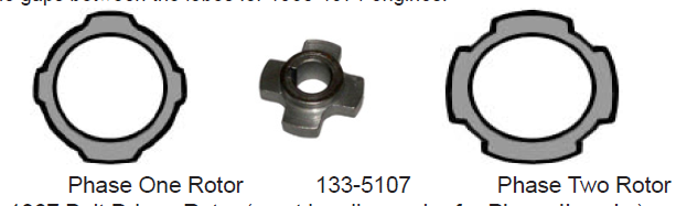

The pase 1 and phase 2 rotor confuse me because on the yellow sheet you have its shown one way and in the CDI troubleshooting book it shows it the other way, dont know which is right. Capture.PNG
I was very nervous about buying an OMC or Sierra box off ebay because of that newer style rotor. I dont even have the older rotor... So I just replaced my CDI with the exact same one and the engine runs now. The CDI box needs the skinny rotor that I am assuming they sell seperately. Mine already had it installed from previous owner I am assuming.
