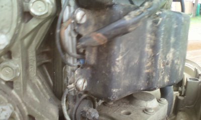

ok so here is an update i checked the engine fuse it is good and i talked to the previous owner and he said that he thinks a wire coming off of the pulse pack could be in the wrong place so i took a pic of the wire and where it goes to is this right i dont have a wiring diagram the wire that has a blue end on it is the wire in question on the pulse pack. IS IT IN THE RIGHT PLACE
It is confusing with these different connecters / colours it means very little to me.---------------It is hooked up to ground on the one end.
