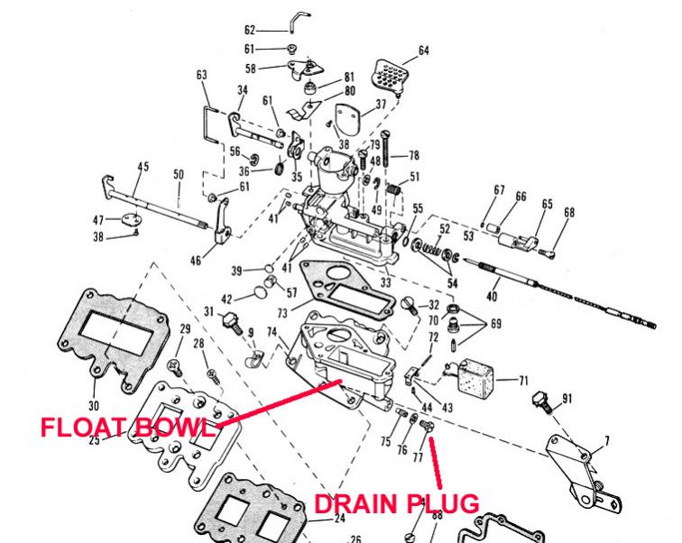

Pull the hex drain plug out of the bottom of the carburetor and see if fuel runs out. Then squeeze the primer bulb to see if more runs out. If it passes the tests, fuel is getting to the carburetor. That doesn't mean it is through the carburetor (main jet). Also, is it really fuel or water? Or gunked up crud.
????---------It was explained that it is a hex head drainplug on the float bowl of the carburetor.--------------Put a 7/16" wrench in your hand and look for that drain plug !
well I just found one with a rubber plug in it and took it out and it didn't do anything at all so the float bowl isn't even near the carb to begin with

took the rubber plug out and lost the bolt I took out so idk what to do now some fuel came out
