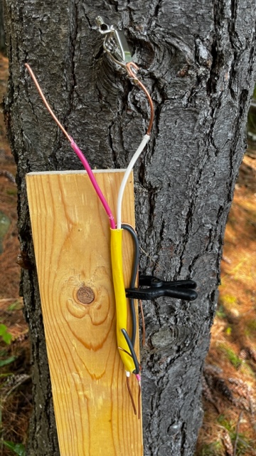

Sparkplugs are not used when putting the magneto to a proper test.----If you have weak spark you will get a good workout on your arm starting this motor.
Just 2 pieces of wire glued onto carboard.----Put a 1/4" gap between them.----Stick one end in plug boot.----Clip other end to engine ground.
Buy a $10 air gap tester, or make something out of scraps, like this,

Hi, I was able to make something as described above.
I put one open wire into wire boot, used alligator plug to attach other wire to spark plug that was screwed into engine.
Result:
- top wire spark jumps .25”
- bottom wire spark does not.
- engine turned a bit without gas tank hooked up
- engine would not start with gas tank hooked up.
Advice on next steps?
Thank you again
You should see a blue white spark you can actually hear snap.
The fact that you have no spark at all on the one cylinder is your first step to address
