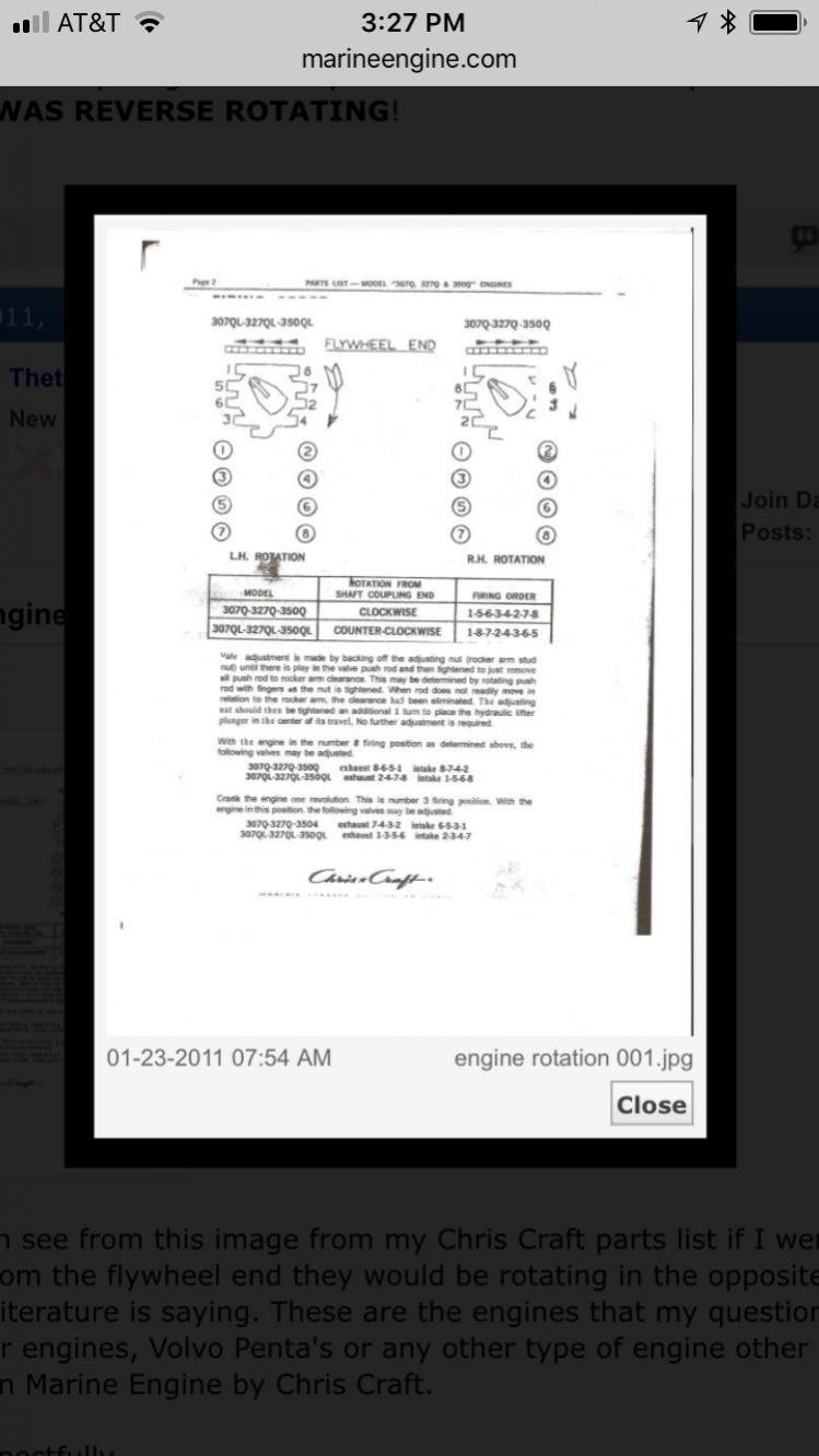

I rebuilt a CC 350QL engine and can not figure the firing order. I need help I have looked on the web and tried every imaginable combination. It is a reverse rotation engine. The firing order on the tag doesn’t work. Can someone who knows what they are talking about help. I have seen reading other post that there seems to be a wide range of those who know and those who think they know. I am not a marine engine guy but thanks to this forum and the advice of some who have posted similar questions I have been able to avoid problems up till now. I used this to wire it up but didn’t get a hit. And yes I have checked to see if I have spark. Please help!

The image that you posted is incorrect regarding the cylinder numbering in relationship to the distributor's physical location. The cylinder numbering is actually being shown as though Up-Side Down.
(see my image below)
If you used your manual page distributor location to orient the cylinder numbering, you may have made a mistake that caused you to incorrectly place your spark plug cables into the distributor cap.
In other words, both the Std LH rotation and REV RH rotation engine distributors rotate CW when viewed from above.
The #1 cylinder distributor cap post remains the same.
Bottom line..... the firing order for your Std LH engine will be 1-8-4-3-6-5-7-2.
The firing order for your REV RH engine will be 1-2-7-5-6-3-4-8.
