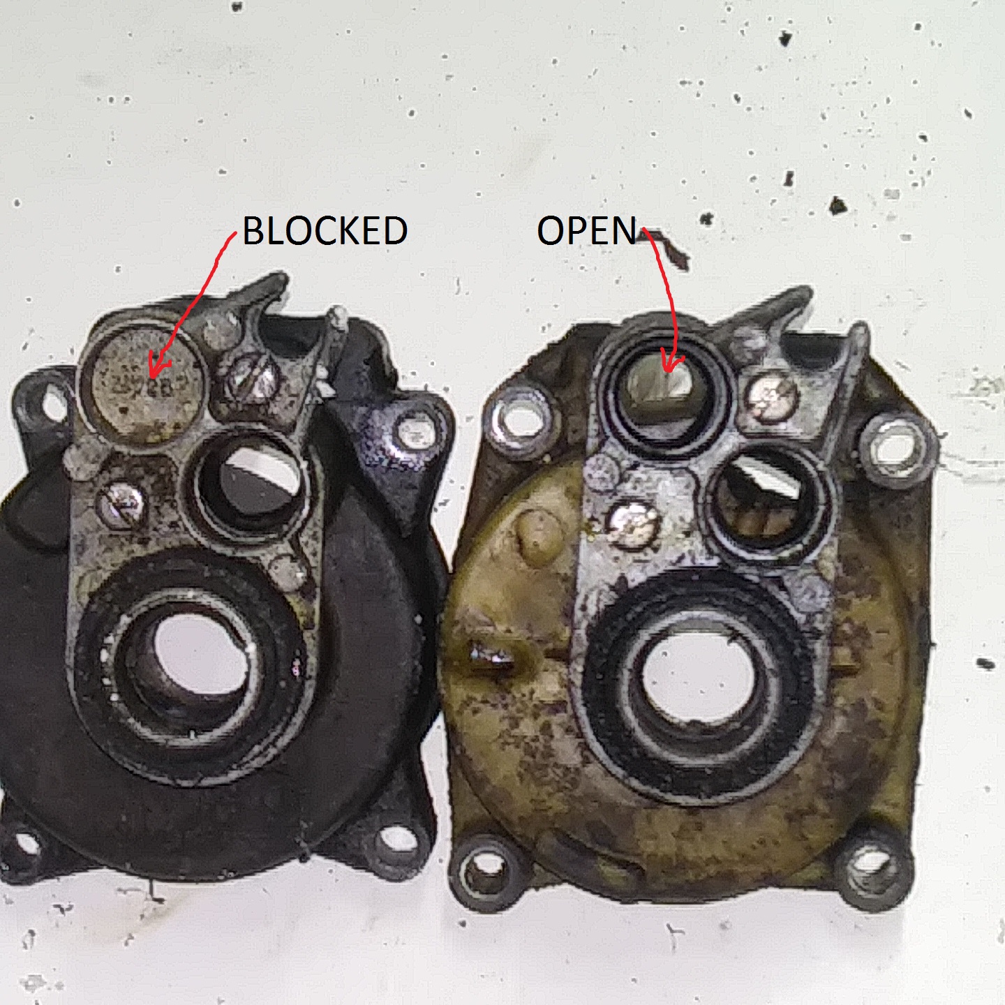

I have 2 water pumps for this motor. One with a solid aluminum housing and one with a plastic housing.

These 2 water pumps are from 1972 65 Hp Evinrudes.
Is the pump on the right missing a plug?
The earlier pumps on the 3 cylinder model ( 1968 to 1971 ) used 2 water tubes.-------1972 was the first year for just one brass tube from the pump to the block.-----So the pump on the right is not missing anything if used on a 72 motor !
One sent water up to the powerhead, The other one was a return tube, sending water back down to the pump for recirculation when the thermostat was closed. Later models did not have the recirculation feature.
Okay, great. They could both work. It also fits with my midsection learnings.

Flip em over and look for putting or scoring....not usually a problem. From the top, they both look nice.
I went with the metal one. It cleaned up nicer. I reassembled the water pump on the lower unit and decided to test it.
