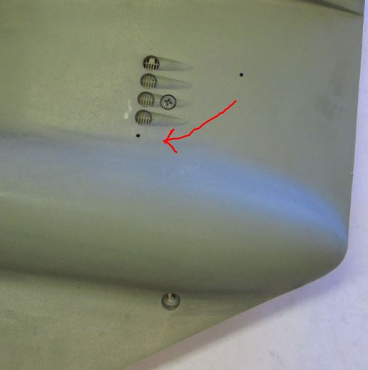

I have one more question, can you tell me what is the small hole just below the water intake, its about 1/8-3/16"?
