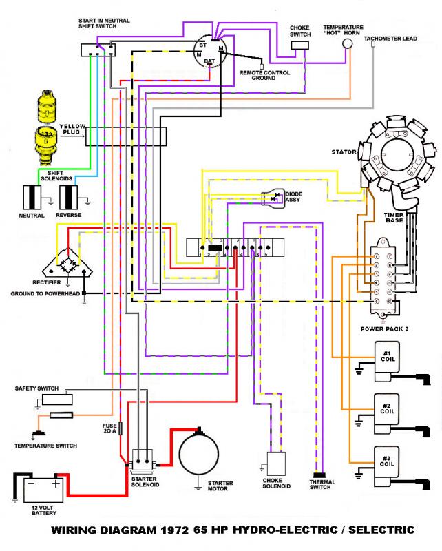

Thank you. I have already verified the electric shift is working. What I am looking for is where all the wire for the motor and the controls connect. Someone has disconnected everything "not very nicely" and I am looking for a diagram if anyone may have one. A diagram of both motor electrical connections and controls electrical connections. Thanks
I don't have the 50hp, but here is the 65hp. Control should be the same, motor same except for being a 3-cylinder with one more coil, etcl
joereeves, I really appreciate the schematic! The problem is when I print it out it's unclear on colors and locations. I hate to be a burden, but would you happen to have a clearer image?
Send me a PM with your email address and I'll send you the two part full page diagram attached. Just remind me of what your email is about. (Joe)
