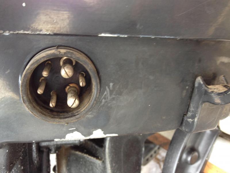

Does it have the 7 pin connector on the motor for the harness?
I'm checking with my buddy, serial #2741917 with MerControl, if that helps.
Via the magic of the Internet he sent this photo.
Thank you for all your help, much appreciated!
