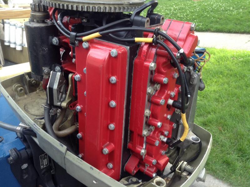

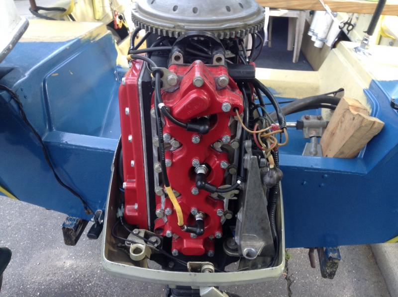

So let me throw some information out first of all my name is Robert and I have been working on this Johnson rebuild for some time now, absolutely love this engine but starting to hit my frustration point....Here's my problem
Over the winter I removed the powerhead, installed new pistons, every single gasket on the powerhead, thermostat, cooling pipes, and water pump. I got everything assembled about 2 months ago and first had a issue with no spark. Well I resolved this issue (hope this is still not a issue) but now I can only start the engine with a touch of throttle body cleaner (I know naughty me) and the issue I'm having is the engine will ONLY run at high throttle. As soon as I attempt to decrease the RPM's she just shuts down. I can start it again but with the same results. I know there is ALOT of professionals on this forums so please give your input.

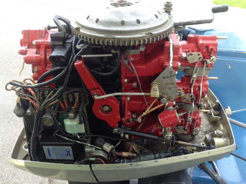

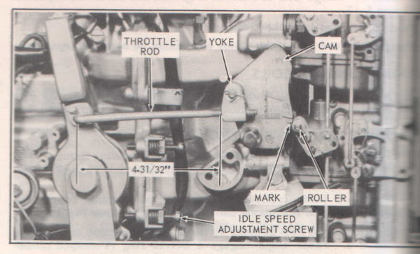

Before the rebuild someone may have adjusted the idle stop screw in order to keep the motor running.----------Back that screw out and see if that helps.
The floats were set flush with the body of the carb, did that according to float recommendations. Yes I am setting the idle air needles. I can adjust the needles and it would smooth out only on high idle. no I did not completely rebuild the carbs just dismantled them, cleaned them and reassembled. I plan on getting a rebuild kit, found a great deal for the rebuild kit. No I did not surface the flange when i had them off but it sounds like I will need to do so and yes I did install new flange gaskets. I will remove the carbs for the mean time until I get the rebuild kits. I will dismantle the fuel pump while I am waiting for the rebuild kits.
Thanks for your advice, I want to try to get it on the lake this weekend to see if it will even start with back pressure. I am fairly confident it will, I will adjust when its warm. This project has got me fairly frustrated but I refuse to give up!
There is only one idle stop screw !---Find that screw and back it out so that throttle / timing will go back far enuff to slow the motor down.--Initial setting for slow speed idle mixture screws is at 5/8 turn out from gently seated !
Ok guys as I get time to think about the motor more and more.....would the motor run if I had the spark plug wires on wrong? I completely dismantled the stator and distributor for inspection and after a few months I couldn't remember the correct locations BUT I am fairly confident they are on right but not 100% sure. I am sure I will have other things that come to mind so please bear with me.
Racerone, I can see the throttle/timing base move accordingly and can see it move back when attempting to idle, one other question I had, I am not 100% sure but is there any particular placement of the rotor? So it goes timing base, rotor, stator/distributor then flywheel.
There is a notch in the crankshaft and the rotor key / tab must fit in it.-----I believe distributor cap is marked 1 2 or 3 for the wires to screw in.
Did you by any chance change this measurement or cam to roller alignment?
