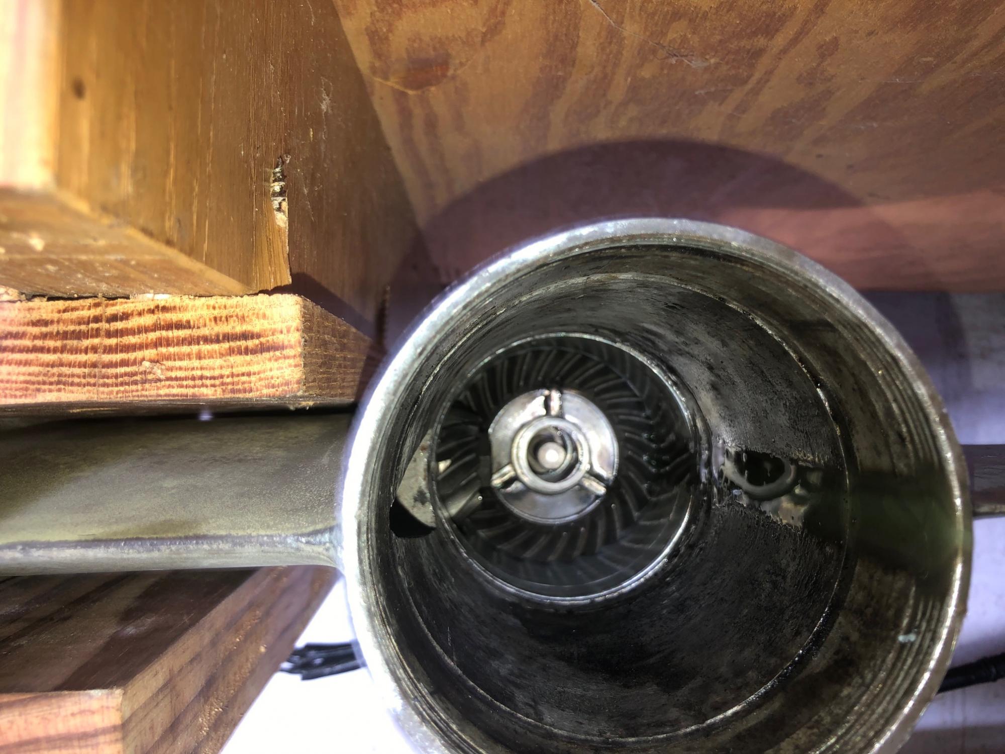

Newb here on this forum. Been restoring an old new boat 1969 Winner MiniKai running a Evinrude 100Hp (100193A) Starflite w/ HydroElectric shift. I own the manuals and have read through existing threads on here to search for the issue i'm encountering. The lower unit shifts fine, however, only under load in forward (Starting to come up onto plane), it jumps/pops (sounds eerily like hitting something underwater). When I drop the revs it runs normal at low RPM. I tried bringing up the RPM in reverse to see if the problem would follow and it would not. This leaves me to suspect that either the DOG or forward gear is warn out. Any suggestions? Thanks in advance.
