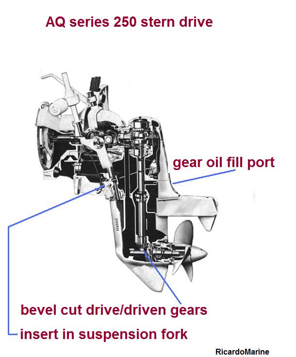

Michael, I'm not aware of a 750 stern drive! Did you mean to say 250 drive?
In or around 1970, the 200 stern drive was being replaced with the 250 stern drive.
If 250, you will see a fill port within the Intermediate housing, and an insert within the supension fork.
These also had bevel cut gears in the lower unit.
