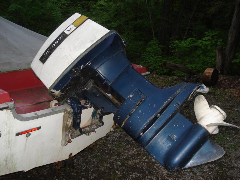

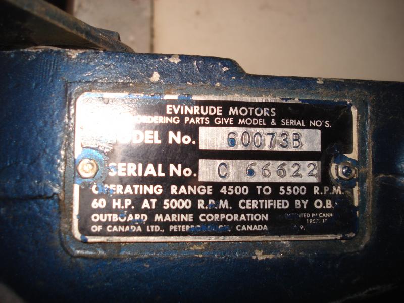

Here are some pics of the engine. This may make it a little easier for someone on the forum here to help me find the proper spark plug selection plus gapping spec for the plug itself....
I had one of those motors one time -----------Ran with L77J4C gapped at 0.035"---------------Went like a 70 HP motor.
