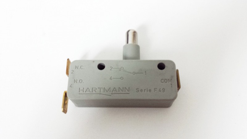

This switch serves as a vice rod limit switch.
As the vice rod approaches the top of it's travel (i.e. fully retracted), this switch opens the Negative circuit to the electric motor.
Here is an OEM part being sold on e-Bay.
https://www.ebay.com/itm/VOLVO-PENTA-850710-5-STERN-DRIVE-SWITCH-MARINE-BOAT-/232865347850
The originals were a Hartman F-49.

The published ratings for the switch referenced only indicate the rating for an AC load. Ratings for mechanical switches for DC loads are usually lower.... and in this particular application, the switch interrupts a running DC motor which is just about the worse case kind of DC load ( a locked rotor DC motor load being one of the worse case applications).
That makes sense, From what I understand it should be 48 VDC.
Mark
If that switch is not intended for DC applications using it on a DC load like this will result in a shortened life. Given that this switch is an industrial grade switch typically rated for 100,000 + operations, a shortened life in your application should still result in several hundreds of operations. I don't know about your use, but I only operate my lift mechanism a couple of times a year.

By design, that limit switch screws into the threaded top of the housing. The nut is there as a lock so you can "adjust" the actuation point so it shuts off the motor at the proper point, i.e. shuts it off before it comes up "hard" against the housing. When you unpower the motor, the motor will "overrun" a very slight amount, so you want it shut off just a tad early. There is an adjustment on the bottom end of the lift rod that impinges on the drive to "fine tune" the length of the rod.

2. Ordered new limit Switch as it was malfunctioning. Ordered the one from Digikey noted above. Was a drop in replacement with no modifications necessary.

By the way, the Hartman F-49 micro switch operates the five pin relay. The relay takes the full amperage load of the electric motor Negative.
