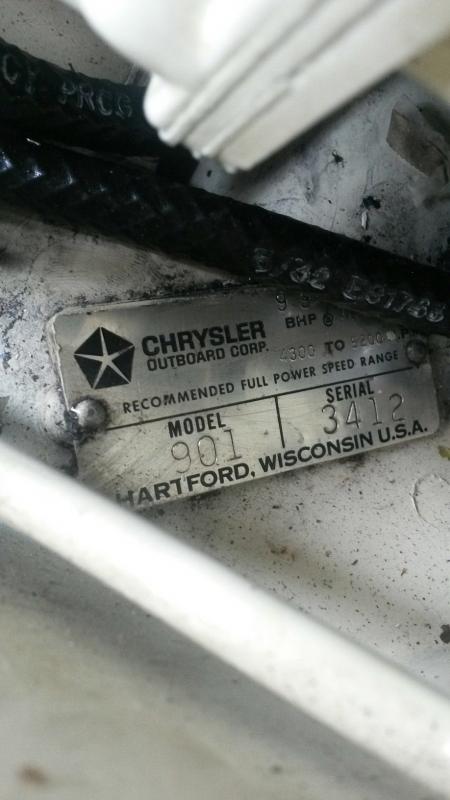

So, yesterday I was driving around and saw a little hole in the wall shop, there sitting was a 9.9 Chrysler with a gas tank. I got it for $100, now I have to figure out what parts I can find... Its a 1968, model # 901 serial # 3412. The only thing I could find by these numbers was that it is a 1968 model. Any help on this subject is appreciated.
What you have there is a rare breed indeed.

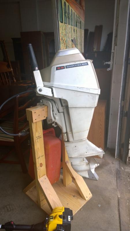

Would you say that this is where the electric starter would be? I can find parts around where I live, just finding an parts diagram for this specific model sounds like its gonna be hard...
Also, is it safe to use some starter fluid on this??
No that's where a pull rope would be hooked up.
Your motor the cover was from an electric start.
Maybe somewhere along the way it was changed or lost?
The starter would be along the side of the motor.

There is the pull cord mechanism, and after I posted about the starter fluid, I tried cranking it and nothing happened. I pulled the fuel pump and it was all gunked up, and I pulled the plugs and the inards are all built up with deposits. I have concluded that this will be worked on over the winter... Full tear down, cleaning, and paint.
