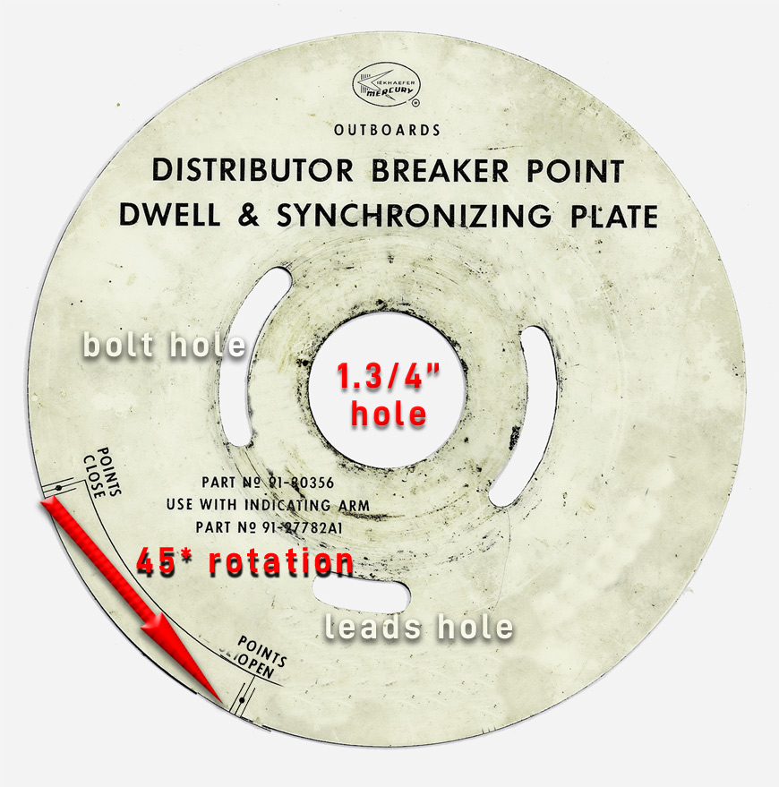

I have the point setup procedure that uses a degree wheel (gray area), the wheel says to set the points at 45* which I would guess is 3 thousands of an inch with a feeler gage.
Here's a full size copy of the timing disk - you can print it then it glue to cardboard or wood, I had an old rotor that I used for putting a pointer on; I don't know what you can use
