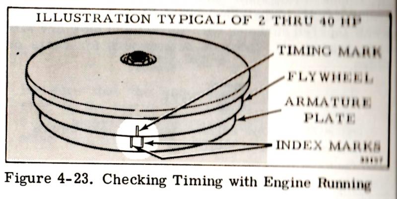

Please note.------A timing light can be used to verify that the points are opening at the correct time relative to the rotation of the magnets on the flywheel.-------That is why it is called a " MAGNETO " on these motors.-------The timing of the carburetor to throttle opening is a different adjustment.----Start the motor and point a timing light at the 2 vertical marks on the magneto plate.---Mark on the flywheel should be in between the 2 vertical marks at all throttle positions.---Check both cylinders.
Since the early 1950's there have been timing marks on the flywheels of all the 2 cylinder OMC motors !!!!!!----These timing marks are not the same as " granpa's 283 chevy " but they are there on the flywheel of this 40 HP outboard motor !
The timing marks are there. Actually intended for using a timing fixture to set the points, but marks on the flywheel can be used to check a running motor.
Next time you have one running just point your timing light at the 2 vertical marks on the magplate.--You will then see the flywheel timing mark , one mark for the top and one mark for the bottom.----I have done this sort of work since about 1968 and all the 2 cylinder OMC motors since the early 1950's have these timing marks !!!!!!!!!!----There are some variations of the actual timing marks depending on the model.----Some are as the above post and some just a notch under the flywheel.--------More that a 100% sure of this.
Using the timing marks to adjust the points / timing eliminates human error.----Feeler gauges " feel different " for everybody.--An ohmeter register infinity at the exact point that the points open.
