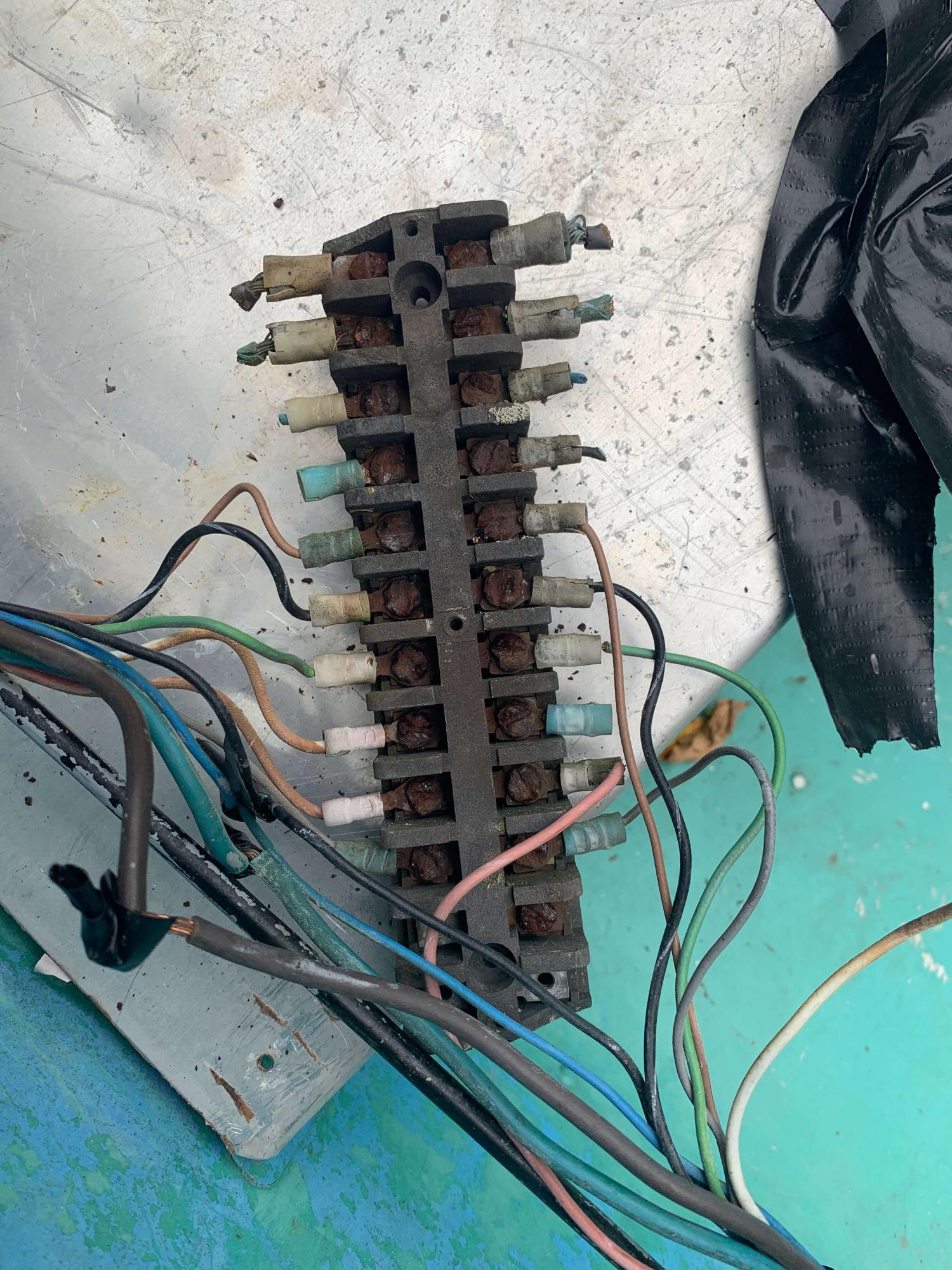

Thank you, i will take a look. The connection points look to be all shot. Ill probably replace all of these. What do you think? Do i need this terminal strip? or can i just wire them back directly to the other wires?

Hoo boy, I have no idea what you are working with there, except it is not original. Somebody has hacked and cobbled. You are going to have to sort that out yourself. Best you begin with a factory wiring diagram.
yeah, I figured it wasn’t original. This connection point is located half way between unit and steering. There is also wiring for choke, amp meter, kill switch, and ignition.

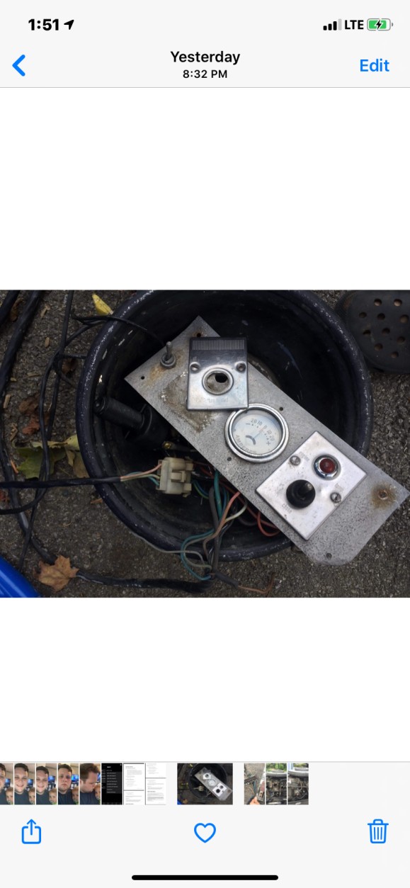

If it has the original instruments, it has an ammeter on the dash to indicate the charge rate.
This is what is came with. It seems to be in working order. Im looking to upgrade the gauge to digital thought. Can i just transfer wires to the digital meter? Also, this is the electric shift wires right? IMG_9751.jpgIMG_5738.jpg
Yes those are the shift wires. As for the digital meter, I don't know what you are planning to use. But I suppose the answer is yes (??) Unless it may require a shunt resistor (??)
