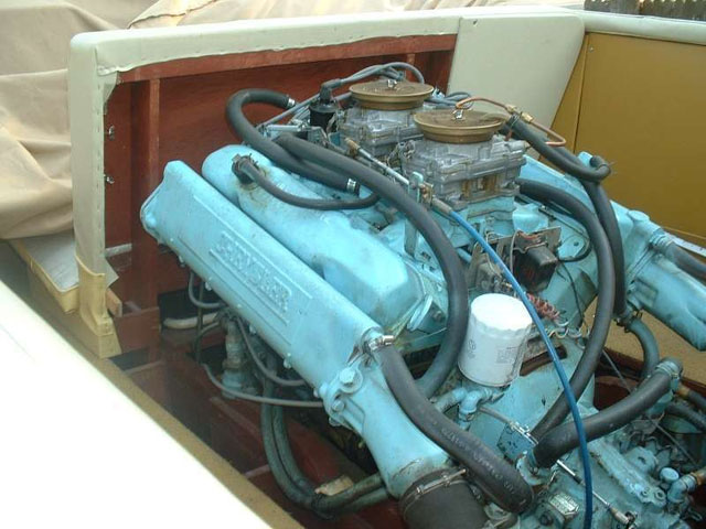

Here is a photo of the t-stat ousing. the system is fed by two hoses and seems to hold a second t-stat. Where can I find this housing. Also, looked for the heat exchanger and could not locate, any suggestions. Also believe some of my over heating is due to old hose collapsing. Is it ok to make the hose longer leading to water pump to eliminate some bend or will this slow the water intake
