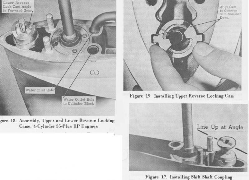

Here's a photo of what you'll find. Note the alignment in the lower right photo.

OK..got it tore apart. I did get it running first, amazed at how quick it started after sitting for 4 years. There is no sign of anything resembling what you show Jeff. I don't know if its missing, or if there was one there. Your pics are different from what I'm seeing. Should the shift rod be able to turn 360 degrees? Mine does, with no sign of locking into reverse. A50 Merc LU 003.jpglso, it was a good thing I took it apart. When I had it running on the muffs, there was hardly any water from the pee tube. Who ever had it apart the la50 Merc LU 001.jpgst time didn't replace the grommet from the pump to the water tube, so hardly anything was getting to the head. Pics attached show what I am looking at.50 Merc LU 002.jpg

This is a later LU than what I thought you had--sorry for the confusion. That said, there IS a part missing, a black plastic cam that works the neutral/ reverse hold down lock.
