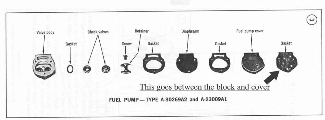

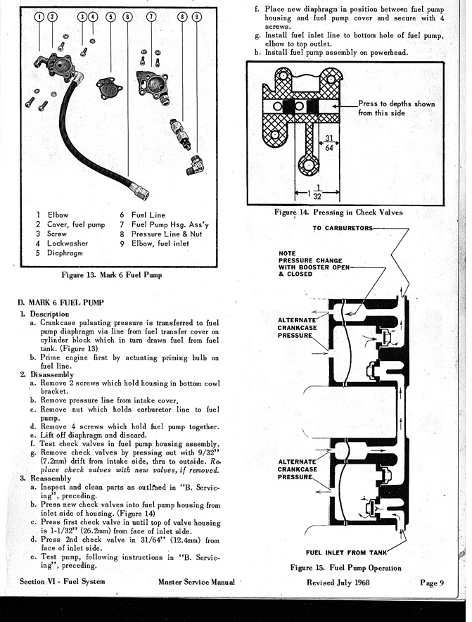

How do I change the check valves without damaging them. Hoping to run this motor next weekend. Bought this little motor 8 years ago and just this year really got into it and this (I hope) is my last step. The motor itself has no plate or decals left on it that's the way I bought it but the pump housings # is 31502. Thanks
