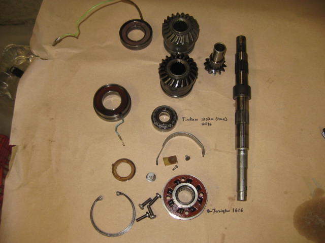

Thanks. Can you recommend which of the forward gears in the picture I should choose to reinstall? The two gears on the top (one on the top left is forward) were from my 'running engine' although I was having problems with the 'running' engine in forward (forward wouldnt work when i got the boat), I replaced gearcase oil with type c and it ran fine for about 1 30min trip, and then same problem where it wouldnt engage and oil a milkshake). The two gears on the bottom are from the 'parts' motor (again forward is on the left). Not only does the forward spring have a raised profile on the spring, but there is a difference on the outer edges of the splines - they protrude abit from the rest of the gear. Any thoughts on which is the better design to reinstall?

On the gears, makes sense what racerone indicated - that design was slightly tweaked over the years. The parts I see for sale on the internet when I do a search on the part # for the front hub show examples of both designs (but same part #!). I just can't tell which is the 'latest' design (assuming later is better). I don't think I am going to sweat it though, just take a pick and hope they work!
