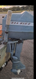

Hello just purchased this Jon boat with a 1962 Sea King five motor on it. It starts up fine with some throttle and will run if I stay on the throttle but as I let off and try to idle it will stall out immediately unless I give it more gas. I have already taken off the carburetor taken it apart and cleaned it. The gasket is a little bit dry rotted, ordering a new one now and float. It has two knobs on the front that control the high speed and low speed needle valves. I have messed with those for a while and cannot get it to idle successfully. Using clean gas with a 25:1 I’m not able to attach the video of it will attach a link to video shortly. Any help is very much appreciated.

The bottom knob should be set 3/4 turn out from lightly seated, the top needle should be 1 1/2 out from lightly seated. Chances are the packing washers are dry and may be leaking air unless you replaced them. Carburetor cleaning involves complete disassembly and a soak in Chem Dip carb cleaner, followed with OMC or Sierra carb kits. Make sure you have good hot spark on both cylinders. Change the impeller and replace the gear oil.
Does spark jump a gap of 1/4" or more?-----Have ignition coils been tested / replaced?--Check the tip of the low speed needle.----Often twisted off.-----I doubt that leaking packing is ever the cause of idle problems.
