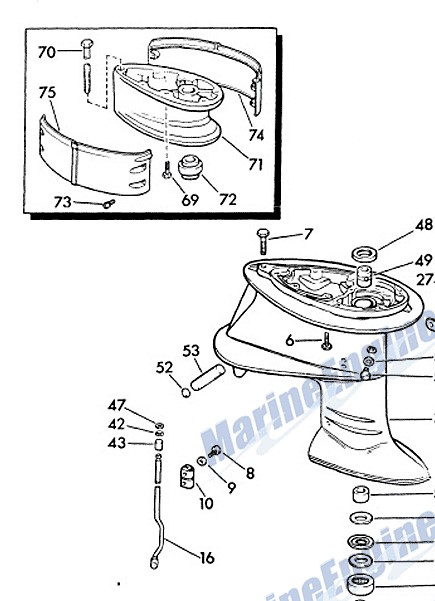

Six bolts? Sorry, there are seven. Six small bolts and one long bolt.​ Once again,, have you removed it? Stop where you are before you break something.
#7===Long bolt (short shaft)
#71===Long bolt (long shaft)
Is it under the extension cover in the rear above the prop?
