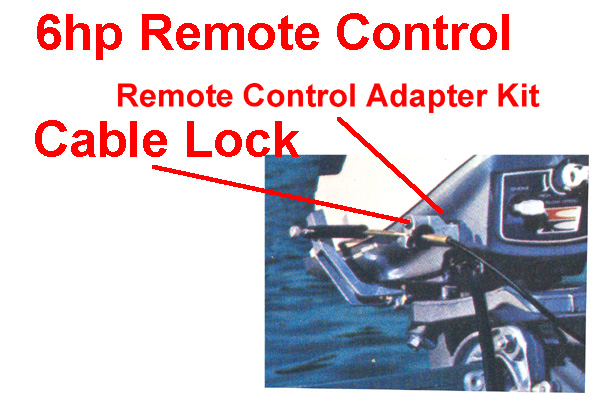

The 5.5 requires an adapter kit to attach the shift cable to the motor. Picture is for the wrong motor, but you'll get the idea. They are pretty model-specific.

I can cleary see the two locations in pictures and understand the need of brackets. I can't seem to find part numbers anywhere for what I'm looking for. It is obvious to me now this motor has the necessary provisions to attach the cables to. I wasn't so sure before as I haven't looked at the motor in a while. Unfortunately no parts diagram or illustrations for the particular unit show either of these brackets in question. The throttle side simply looks like it would be a cable clamp style bracket. I assume the shift bracket is a two bolt ordeal underneath the small rectangle cover on the passenger side of the motor. If anyone happens to come up with or know part numbers that would be great. I'm thinking something like 321637 would work but it's for newer machines.
Thank you very much! I really do appreciate you "spoon feeding" me lol. Looks like this is going to be alot more simple than I previously anticipated. Now I Just have to figure out my steering situation!
