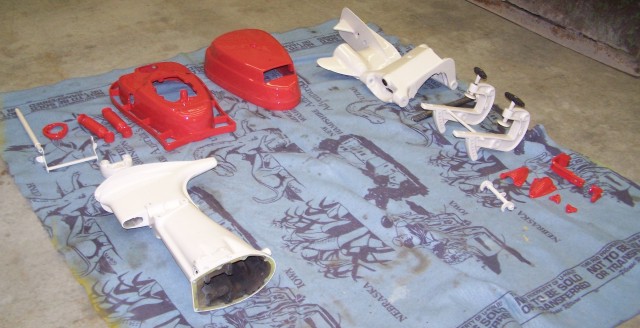

I do that work in the winter time, it is not a cheap process. I did a 59 last year that won best motor at the acbs manotick ON Canada boat show. It was a 4700$ CDN job with all the polishing and rechrome of those parts.
I strip the motor completely and each part is beaded and properly painted with the right colors then reassembled with all new bolts etc. I rebuild the igntion, carb, fuel pump(s) new lines, repair replace the harnesses and rebuild the starter as well.
This winter i have a long list of motors Merc Mark 20-h, Mark 55H, 1958 Mark 58 sunset and tan, Mark 75H, Merc 650XS and 1500XS. currently I am doing a Mark 20H and Mark 55H for a customer in Windsor, Canada.
Doug Kay in the US is another great option, he is unbelievable with the work he does, I am not sure on his schedule he has been working for a couple of brothers with a HUGE racing collection and restoring for them non-stop for the last couple years.

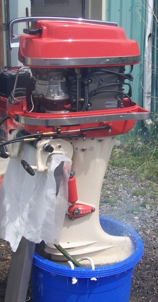

here are couple shots of the one I did last year.
Re: '59 45hp Kiekhaefer Murcury Thunderbolt restoration/rebuild
Nice except for the red shocks! What ere you thinking?
Jeff
PS: The 44 cube four cylinder--made from the late '40s 'til 2000--was the best damn motor Carl Kiekhaefer ever built! Period. Seeing a new 40-50 hp outboard costs a fortune, why the heck not rebuild an older one, especially a 44? Makes sense to me, that's why I have a couple. They also weigh at least 50 POUNDS less!

Jeff,
The customer wanted the shocks that colour and they were an option in those years I have a 57-58-59 catalog and also shows in my DR owners manuals that the shocks came matched to the cowls.
