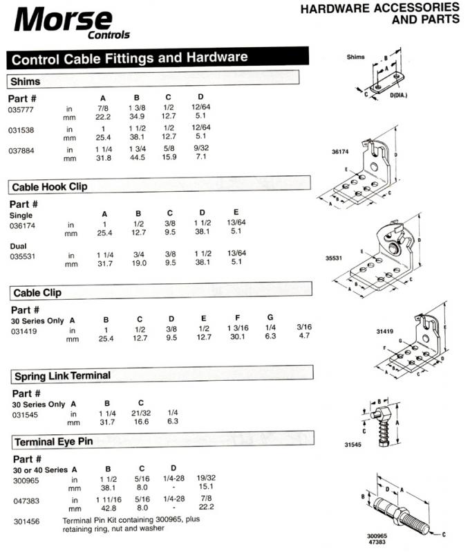

The 33C cables use a different type of lock than the OMC cables do. Just a bit of history: The 33c cables and controls were developed by Morse Controls. They were pretty universal, adaptable to most anything. Of course, this is 2014 and many changes have been made. One of the changes is Teleflex bought the Morse Controls company. At that time, Teleflex was already making their version of the Morse design and copies of their cables. So what you get is what survived the merge, plus Teleflex's own new designs.
This page from the 1998 Morse catalog shows the cable clips (locks) for adapting 33C cables to old Evinrudes. Time takes its toll on memory, but I believe 31419 is the one you need.
