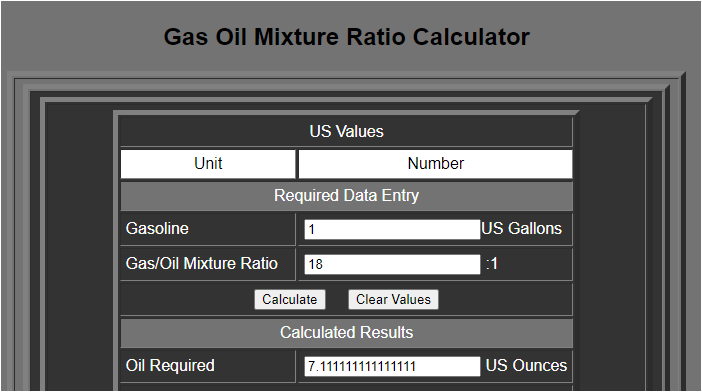

18:1 mix would be 7oz oil to 1 gallon gasoline.
